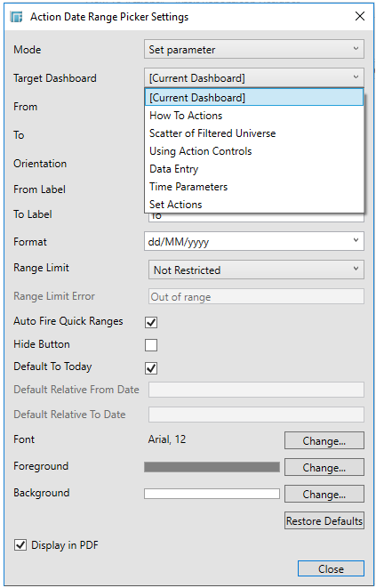

The Action Date Range Picker Settings dialog displays.
There are two Mode options for making defining settings for Action (i.e., Use Action) and Parameter (i.e., Set Parameter).
If Set Parameter is selected, select the Target Dashboard. Otherwise, proceed to step 5.
The default is Current Dashboard. When copying the action control to another dashboard or workbook, the target dashboard is automatically set to the new dashboard instead of where it was originally located.
This populates the From and To drop-down lists of the parameters that are defined in the selected target dashboard. Proceed to step 6.

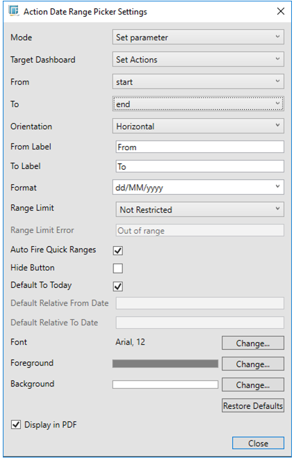

Select the parameters that will be used for the From and To dates range.
Select the Orientation:
Horizontal
Vertical
You may opt to set new From Label and To Label.
Select whether to display both the date and time in the control in the Format drop-down.
The text of the date can be directly entered.
NOTE: The To date must be greater than the From date.
Click anywhere in the dashboard to apply the change.

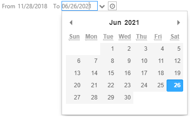

In the Web client, aside from entering the value, you can also click on a date to bring up the date range picker and select a new one.

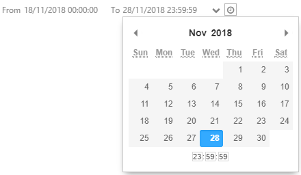

In the Web Client, the From date will be now-7D and the To date will be now by default.
For example, now is November 28, it will go back 7 days (November 21) and then the date will be recalculated.
In addition, you can use the SIGN UNIT NUMBER pattern in the Web client to modify the relative date calculation.
For example, if you enter -1M:
The recalculated relative date will back 1 month from today (e.g., October 28):

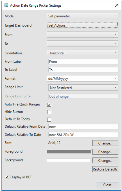

Complex expressions can also be entered to recalculate the relative date ranges. These expressions are evaluated from the left to right pattern. The now term can also be used as a pointer to the currently evaluated value of the relative time expression.
For example, if you enter now-5M-2D+3Y as the Default Relative To Date and now as the Default Relative From Date:
In the Web client, the To date will be now-5M-2D+3Y by default.
In the expression, you can also use startOf and endOf functions. Both functions take the same arguments, a relative time string, and a unit.
Lastly, you can define a complex expression with the functions. For example, if you enter startOf(now-7D, W) as the Default Relative From Date and endOf(now, D) as the Default Relative To Date:
In the Web client, the From date will display the start of the previous week and the To date will display the end of the current day:

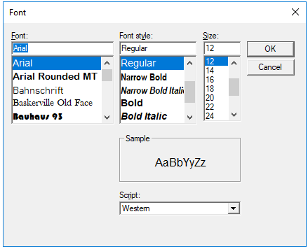

To modify the style settings of the Action Date Range Picker, make the necessary changes in the following controls:
Font - Click Change to display the Font dialog where you can set the Font Type, Style, Size, and Script.
