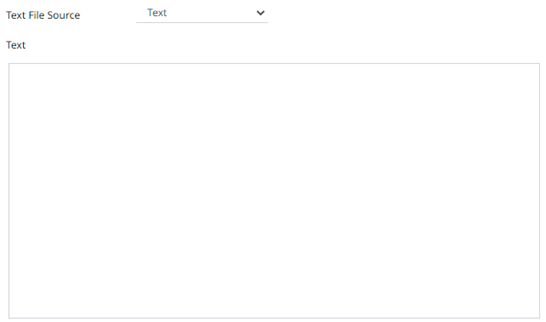

· Text
Enter the text block to be parsed.

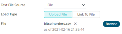

· File
You can either:
¨ Upload a data source snapshot by clicking
Upload File
then Browse
to
browse to the file source.
After selecting the file, it is displayed with the timestamp of the snapshot.
To
change the data source, click
then
Browse
to browse to a new version of
the file.
¨ Link to a data source file by clicking
Link to File
and entering a Text File Path.
Ensure that in a cluster, you need to use a a shared path, or put it on every node and use a path that resolves on every node. You can update its contents whenever you want.

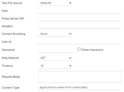

· WebURL
The dialog changes slightly to allow specification of the following:
Property |
Description |
Path |
The absolute path including the HTTP where the Text file is located. |
Proxy Server URI |
The HTTP Proxy setting that will allow the Text connector to reach the endpoint |
Headers |
· Headers are separated by a comma · Each Header is entered as Name = Value, where Name and Value can be enclosed in double quotes to allow inclusion of any character except for double quotes · Name and Value can also be left unquoted, in which case they may not include comma or equals characters |
Content Encoding |
Select the Content Encoding with the HTTP Header: None, GZip, Deflate, or GZip and Deflate |
User Id |
The user Id that will be used to connect to the Text service. |
Password |
The password to connect to the Text service. |
Http Method |
Select the HTTP Method to map any of the following operations to HTTP requests
· GET – retrieve information · POST – create or update an entity · PUT – replace an existing entity · DELETE – remove a request |
Timeout |
The length of time to wait for the server response (10 to 300). Default is 10. |
Request Body |
The Request Body for HTTP POST. |
Content Type |
The required Content Type. Default is application/x-www-form-urlencoded |
