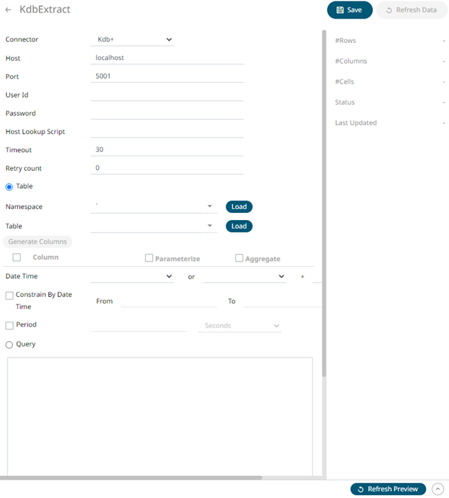

Creating Data Extract from Kx kdb+
The Kx kdb+ connector allows connection to the Kx kdb+ databases on a polled basis.
1. On the New Data Extract page, select Kdb+ in the Connector drop-down list.
2. Enter the following properties:
Property |
Description |
Host |
Kx kdb+ host address. |
Port |
Kx kdb+ host port. Default is 5001. |
User Id |
The user Id that will be used to connect to Kx kdb+. |
Password |
The password that will be used to connect to Kx kdb+. |
Host Lookup Script |
Key of the authentication script setting that will be searched in the connector.host.lookup.scripts property in the Panopticon.properties file. The authentication script setting will issue a shell script call passing a JSON structure containing host, port, username, and password (as below). { "host": "host", "port": 5001, "username": "username", "password": "password"} NOTES: · The port should be a number and has no double quotes. This is done to avoid unwanted casts. · Only host and port are mandatory. Calling the script in-process from the Tomcat server running Panopticon allows automatic pick-up of the Kerberos token of the system account that started the Tomcat process. NOTES: · An exception will be thrown if the key used in the connector is not configured in the Panopticon.properties file. · This Host Lookup Script value can be parameterized. |
Timeout |
The length of time to wait for the server response. Default is 30. |
Retry Count |
For long running queries, a query timeout can be specified to prevent the server from locking up. Default is 0. |

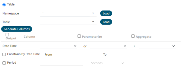

3. When Table is selected, the section below is enabled:
The Namespace drop-down is an editable combo box.
You can either:
· click
and
select a namespace from the list of all root level namespaces. By
default, the selected namespace will be root (backtick `).
· For nested namespaces, enter them in the Namespace box (e.g., panopticon.test) to get the tables that were created under these namespaces.
4. On the Table field, click
to
populate the drop-down list with tables and views. Select a table
or view.
5. Click
. The columns of the selected table
or view populates the Output Column section.
6. Individual columns can be added by checking the corresponding Column box in the Output Column listing.

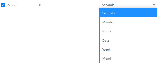

11. In Kx kdb+, you can modify the query to regroup the aggregated data per time units (i.e., Seconds, Minutes, Hours, Date, Week, Month). Check the Period box, enter the time duration and click then select the time unit.
