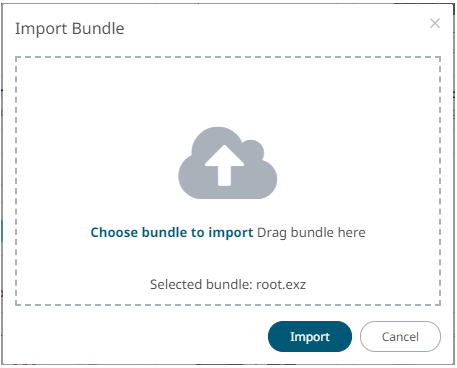

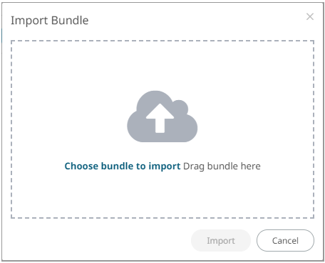

1. Right-click on a folder and select Import Bundle on the context menu.
The Import Bundle dialog displays.
2. To import a bundle, you can either:
· drag it from your desktop and drop on the dialog, or
· click Choose Bundle to Import and select one on the Open dialog that displays.
The name of the selected bundle is displayed on the dialog box.
3. Click
