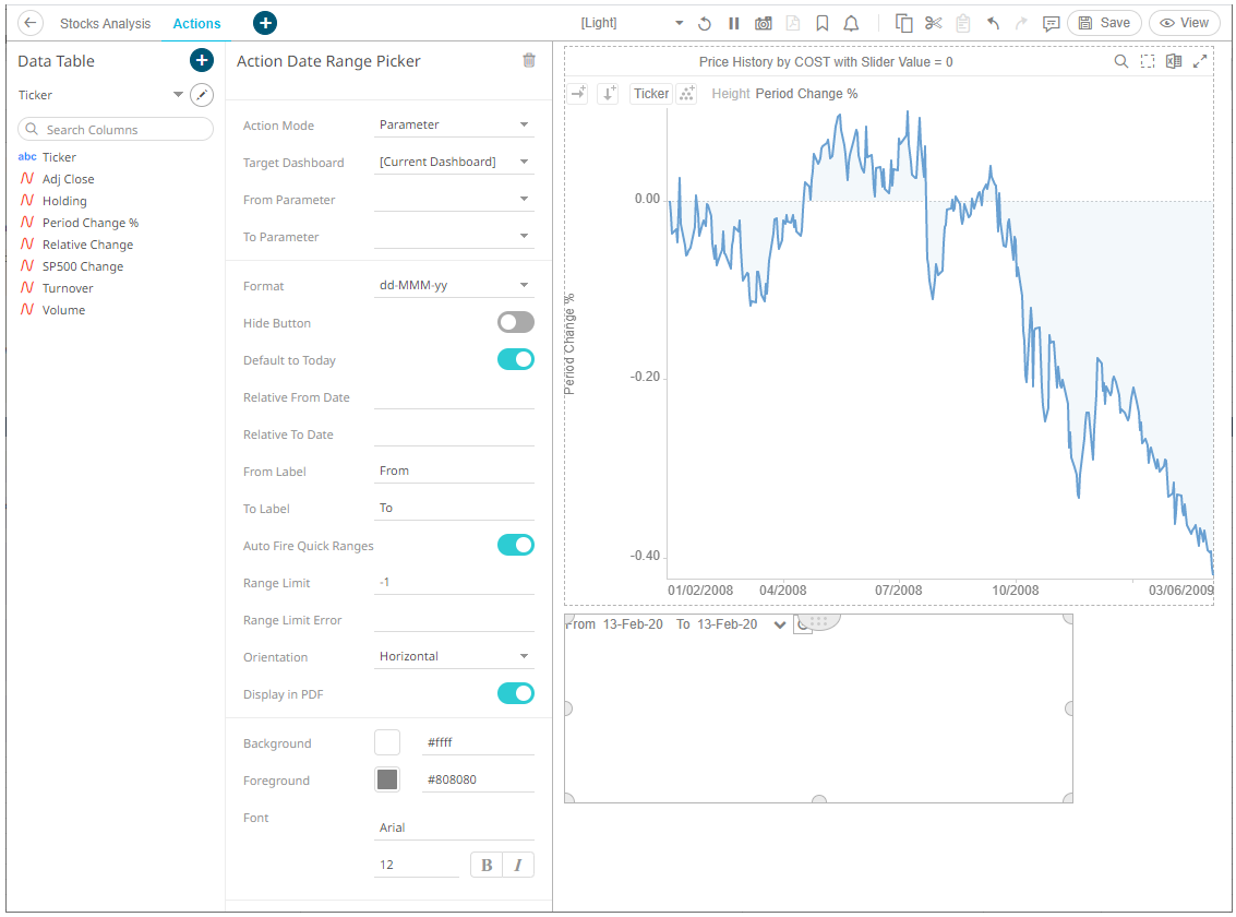

1.     After double-clicking or drawing a rectangle on the dashboard canvas, click  on the Select Part pane then click the Action Date Range Picker  icon.
The Action Date Range Picker pane is displayed, and the Action DateRamPicker part is added on the dashboard canvas with the current date range (parameters From Date to To Date) and the Set Range button.
2.     There are two Mode options for defining settings for Action and Parameter.
·         If Parameter is selected, select [Current Dashboard]
This means, when copying the action control to another dashboard or workbook, the target dashboard is automatically set to the current dashboard instead of where it was originally located.
This populates the From Parameter and To Parameter drop-down lists of the parameters that are defined in the selected target dashboard.
·         If Action is selected, select the Action to be used by the control
This populates the From Parameter and To Parameter drop-down lists of the parameters defined in the selected action.
3.     Select the parameters that will be used for the From Parameter and To Parameter dates range.
4.     Enter the Date/Time Format.

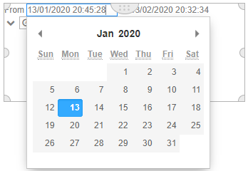

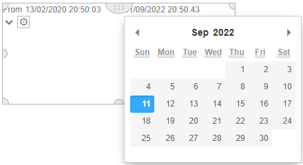

Clicking on the Date/Time box displays the current month.
The text of the date can be directly entered, or alternatively it can be clicked on, to bring up a date picker in the Web client.
5.     Tap the Hide Button slider to turn it on. This means the action control will update the parameter whenever the value of the data picker changes.

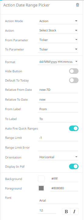

¨        now-7D will set the date picker to 7 days ago. This is the same as specifying 7D

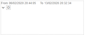

For example:
The From date will be now-7D and the To date will be now by default.
For example, now is February 13, it will go back 7 days (February 6) and then the date will be recalculated.

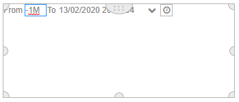

For example, if you enter -1M:
The recalculated relative date will be January 13:

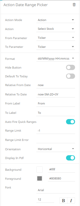

Complex expressions can also be entered to recalculate the relative date. These expressions are evaluated from the left to right pattern. The now term can also be used as a pointer to the currently evaluated value of the relative time expression.
For example, if you enter now-5M-2D+3Y as the Relative To Date and now as the Relative From Date:
The date will be now-5M-2D+3Y by default.

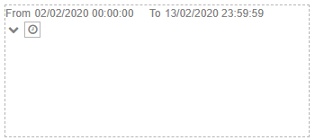

Lastly, you can define a complex expression with the functions. For example, if you enter startOf(now-7D, W) as the Relative From Date and endOf(now, D) as the Relative To Date:
The From date will display the start of the previous week and the To date will display the end of the current day:

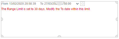

10.   When a Range Limit has been set, the Range Limit Error box is enabled. It is mandatory to enter an error message to help in defining a better input to match the set limit. (Default: Out of range)
For example: “The Range Limit is set to 30 days. Modify the To date within this limit.”
