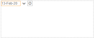

The Action Date Picker pane is displayed, and the Action Date Picker part is added on the dashboard canvas with the current date and the Submit button to the right.

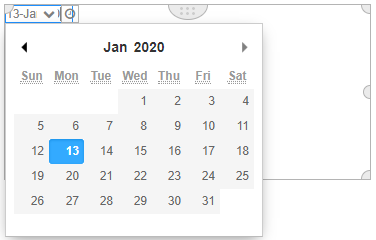

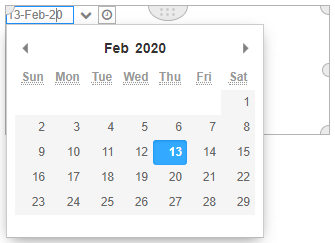

Clicking on the Date/Time box displays the current month.
The text of the date can be directly entered, or alternatively it can be clicked on, to bring up a date picker in the Web client.

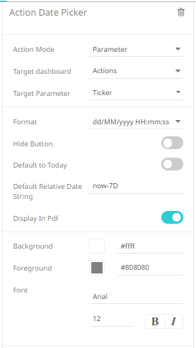

· now-7D will set the date picker to 7 days ago. This is the same as specifying
-7D
For example:
The date will be now-7D by default.
For example, now is January 15, it will go back 7 days (January 8) and then the date will be recalculated along with the Date/Time format.

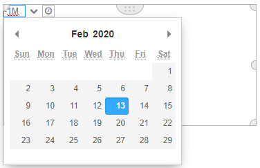

For example, if you enter -1M:
The recalculated relative date will be January 13:

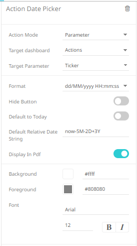

Complex expressions can also be entered to recalculate the relative date. These expressions are evaluated from the left to right pattern. The now term can also be used as a pointer to the currently evaluated value of the relative time expression.
For example, if you enter now-5M-2D+3Y in the Action Date Picker Settings pane:
The date will be now-5M-2D+3Y by default.

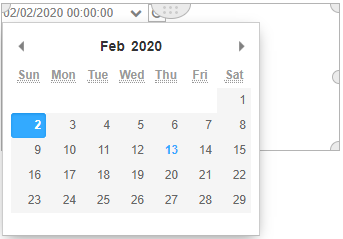

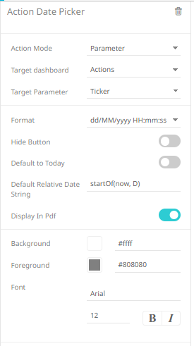

For example, if you enter startOf(now, D):
The date will display the start of the current day:

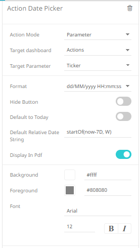

Lastly, you can define a complex expression with the functions. For example, if you enter startOf(now-7D, W):
The date will display the start of the previous week:

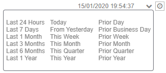

· The Default Relative Date will be used if the dashboard parameter is null/empty. · The relative Date/Time string is case sensitive. · You can also opt to select from a pre-populated date ranges:
Refer to Selecting Relative Dates in Action Date Picker and Action Date Range Picker Controls for more information.
