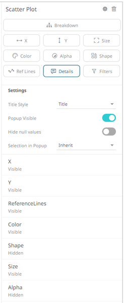

1. Click on the Details button of a visualization. The Details Settings pane displays along with the available variables of the visualization.
Sample 1: Scatter Plot visualization has HeightX, HeightY, Size, Color, Alpha, Shape, and Reference Lines variables.

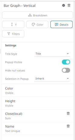

Sample 2: Bar Graph – Vertical visualization has HeightY and Color variables.
2. Select the Title Style: Title, Visible Path, or Full Path.

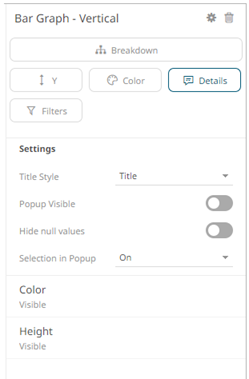

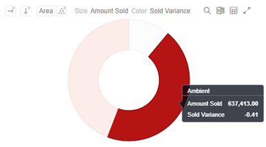

3. Tap the Popup Visible slider to turn it on.
4. Tap the Hide Null Values slider to turn it on.

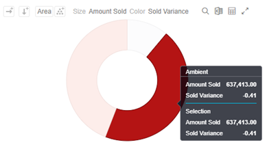

5. Select the Selection in Popup:
· On
The Details pop-up of the selection in the visualization is displayed.
· Off
The selection in the Details pop-up is turned off.
· Inherit
The selection option in the Details pop-up is inherited from the workbook properties.

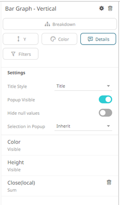

6. You can also drag and drop numeric columns from the Data
Table pane to the Details
button on the Visualization Settings pane.
The column is added under the Details pane.
7. Click on the column to display the configuration pane.
8. Enter the label of the Details variable in the Variable Title field.
You can parameterize the variable title to support dynamic schema in the dashboards.
9. You can opt to change the column to the be used from the Column drop-down list.
10. Specify an aggregation method in the Aggregate field.
The default is Sum.
