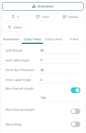

Cross Tab Axes
Visualizations that support cross tabbing, include the following settings for both the X and Y axes.
Setting |
Description |
Leaf Margin |
The margin allocated to the leaf or lowest level of data of the crosstab axis. Default is 80. |
Leaf Label Angle |
The Label angle of the leaf or lowest level of data of the crosstab axis. Default is 0 and maximum is 90. |
Inner Bar Thickness |
The width or height allocated for the non-leaf components of the crosstab axis in pixels. Default is 80. |
Inner Label Angle |
The angle of the non-leaf labels. Default is 0 and maximum is 90. |
Min Interval Length |
The minimal interval in pixels between cross tabbed visualizations. Default is 100. |
Max Interval Length |
The maximum interval in pixels between cross tabbed visualizations. Default is 400. |
Word Wrap |
Determines whether to wrap the crosstab axis text. |
