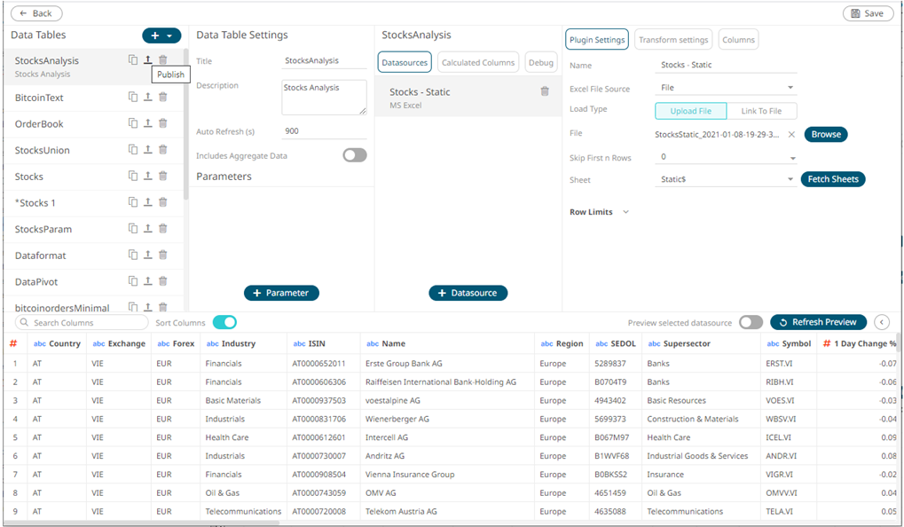

1. Click the Upload Data Table
button of a data table in the
Data Tables list.

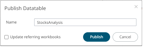

The Publish Datatable dialog displays.
2. You can opt to enter a new Name of the published data table template.
3. Check the Update Referring Workbooks box to update the workbooks using the data table.
4. Click
An error message displays if an existing data table with the same name is already available.
Enter
another name and click
. The published
notification message displays.
