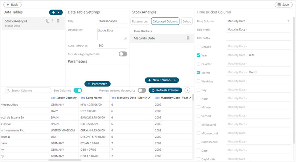

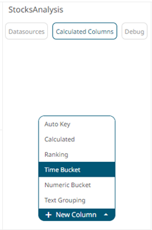

2. Click New Column > Time Bucket.

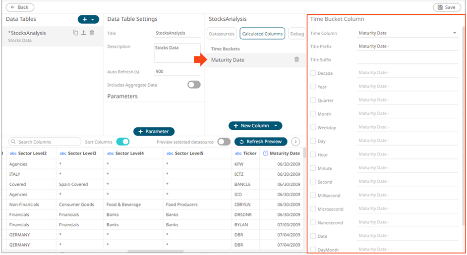

The Date/Time column (e.g., Maturity Date) that will be used for the time bucketing is displayed under the Calculated Columns pane and the Time Bucket Column pane also displays.
3. Enter the Title Prefix.
4. Enter the Title Suffix.
5. Select the required time buckets.
6. Click
. The new time bucketing column is added
and displayed in the Data Preview.

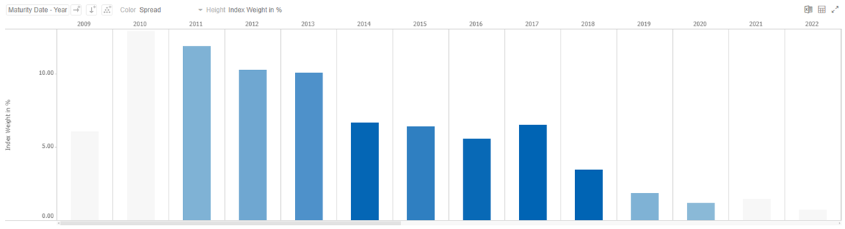

By creating the Year Time Part, a Bar graph of Maturity Year can be displayed:

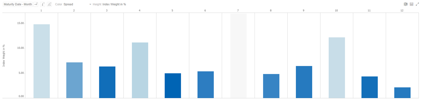

Similarly using the Month Time Part, a Bar graph of cumulative issuance by Month can be displayed:

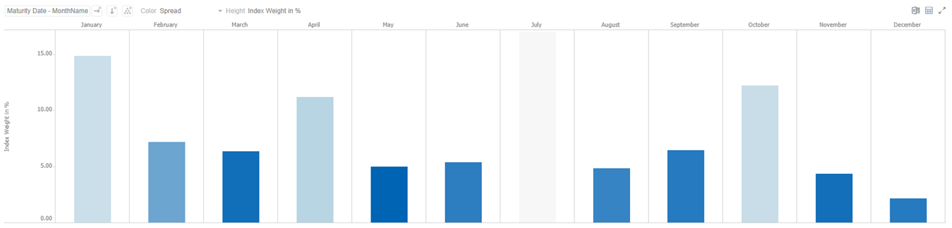

Using the MonthName Time Part, a Bar graph of cumulative issuance by Month Name can be displayed.
