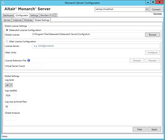

Global Settings
To customize global settings, select the Configurator tab, and click the Global Settings tab.
The following settings are available on the Global Settings page:
q Global License Settings: Modify the global license source to be used. The specific steps are detailed here.
q Global Settings:
· Log level: Select the log level from the drop-down list (the default value is All).
· Log size (kb): Enter the log size (the default value is 1024).
· Log max archived files: Enter the max number of archived files (the default value is 50).
· Global timeout: Enter to set receiveTimeout for all URI schemes. The receiveTimeout setting can be configured manually for each particular scheme via config.xml.

To save changes, click Apply.
