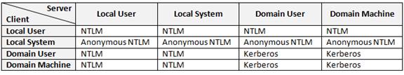

q In Step 7, in the Service account dialog box, you specify the logon account for MS services. If you specify a custom user in the Account name field, NTLM authentification is applied.
The following table provides details on the interaction of services in case of distributed installation.

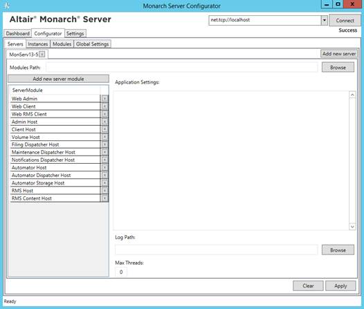

To configure the list of services
1. Select the Run Configurator option from the Start menu.
The Configurator will be launched.
2. From the drop-down list in the top right corner in the Monarch Server Configurator window, select the domain server name and port where the Configuration Service runs, and click Connect.
3. Under the Configurator tab, select Servers, and configure the list of services that should run on each server.
