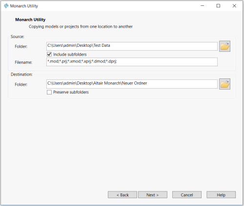

  1. Launch the Monarch Utility and select the button Copy models or projects from one location to another from the Monarch Utility wizard that displays. Click Next.
  2. In the next screen that displays, enter the path to the source folder containing the files you want to move. You can use the Browse  button located beside this field to search for the appropriate folder.
  3. Check the box for Include subfolders if you wish to copy all subfolders as well.
  4. In the next screen, enter the path to the destination folder in which to place the copied files. You can use the Browse button located beside this field to search for the appropriate folder.
  5. Tick the box labeled Preserve subfolders if you wish to retain the same folder structure adopted in the source folder when the selected models or projects are copied. Note that this field only displays when the Include subfolders option in Step 3 is enabled.
  6. Click Next when you are finished.
