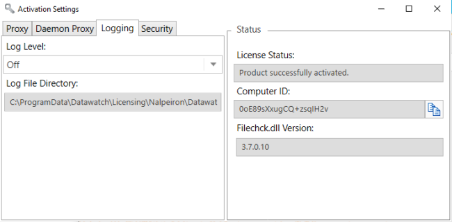

Depending on your license code, log files for activation settings in Monarch License Manager may be found in C:\ProgramData\Datawatch\Licensing\Nalpeiron\Datawatch Monarch 17 or C:\ProgramData\Datawatch\Licensing\Nalpeiron\Datawatch Monarch Subscription. You can change the amount of information provided in the log files via the Logging tab of the Activation Settings window.

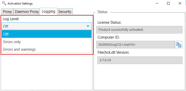

  4. In the Activation Settings window that displays, select the Logging tab.
  5.
  6. From the drop-down menu, select a log level.
  7.
    Accepted values include:
    • Off
    • Errors Only
    • Errors and warnings
