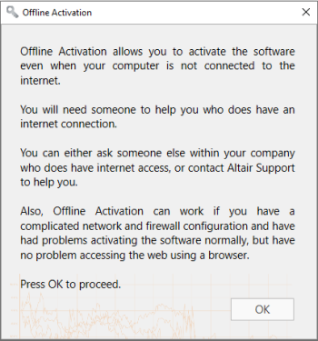

In the Activate License screen that displays, enter your activation code into the field provided and then select the Offline Activation button to display the Offline Activation screen.
The following note displays.
Select the Offline Activation button to display the Offline Activation screen.
With your systems administrator or Altair Support, follow the instructions provided in this screen to manually update your Monarch installation.

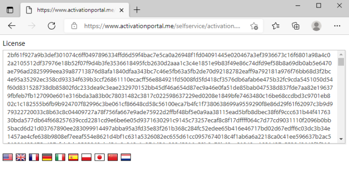

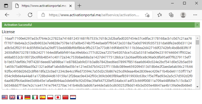

Copy the generated Activation Certificate and paste it into the Activation Certificate field in the Activation window you opened in your browser. Select Activate when you are done.
A license is generated.
Copy and paste the generated license into the License field provided in the Offline Activation screen (Step #6). Click Activate when you are done.

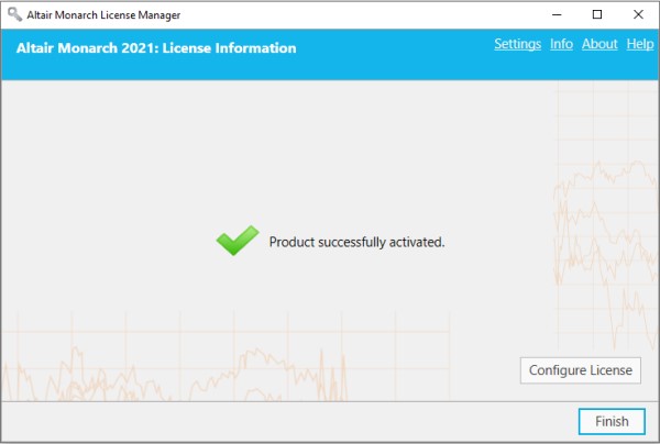

Upon successful activation, the following screen displays.
Select Finish when you are done.
