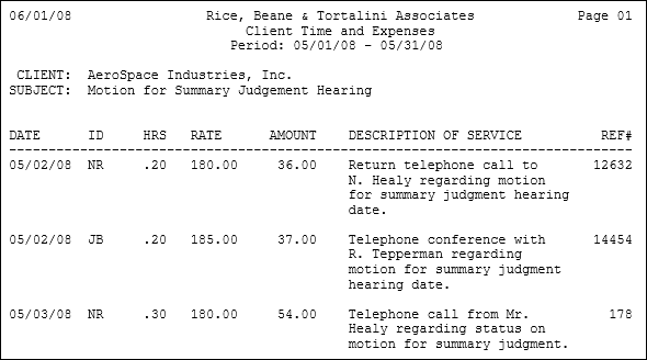

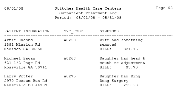

Some reports contain description fields that wrap onto multiple lines. Some multiple line fields always occupy a fixed number of lines, but others occupy a variable number of lines. An example of each appears in the illustrations below.
The SYMPTOMS field always contains a fixed number of lines.
The DESCRIPTION OF SERVICE field contains a varying number of lines.

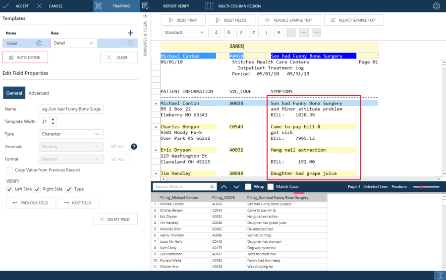

  7. Highlight the first line of the multiple line field. You may also highlight any single-line fields that you might want to extract using this template.
  8. Click on the first line of the multiple-line field so that its properties display in the Edit Field Properties portion of the Template and Field Properties panel.
  9. In the General tab, type a name for the field in the Name box and then specify settings for each of the available options (Note: For a detailed explanation of these options, see Input Field Properties).

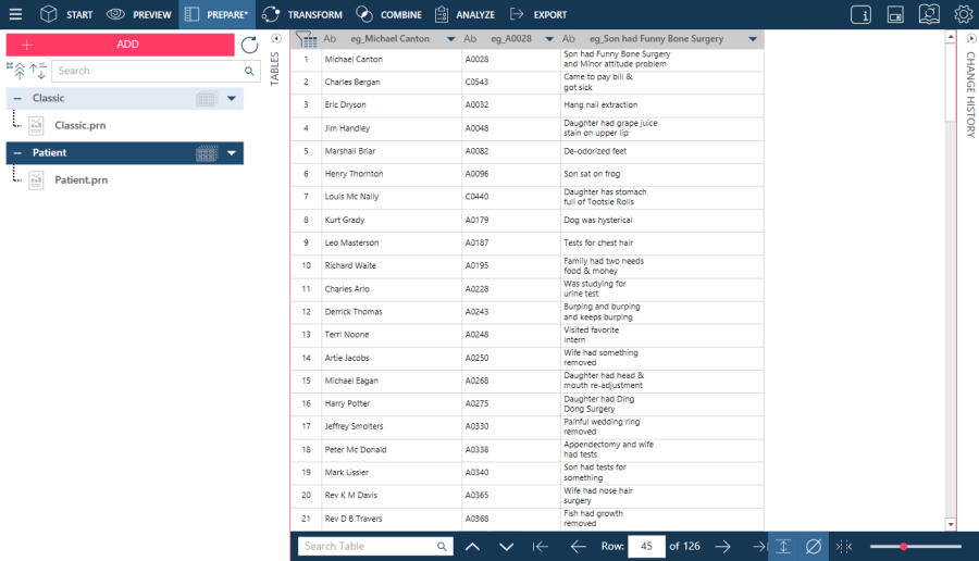

    The extracted data display in a table in the Prepare window.
