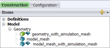

![](../../../../images/feko/user_guide/cadfeko/dialog_panel_tree_model_mesh_overview.png)
Figure 1. Example of (1) a geometry part that was meshed and has a simulation mesh, (2) a mesh part without a simulation mesh (still needs to be meshed) and (3) a mesh part that has a simulation mesh.
- The
icon indicates a mesh part or model mesh.
- The
icon indicates that a mesh instance has already been created or defined. This mesh instance is used when simulating the model.
