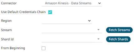

1.     In the New Data Source page, select Input > Amazon Kinesis – Data Streams in the Connector drop-down list.
2.     You can either:
·         check the Use Default Credentials Chain box to use the default Access Key ID and Secret Key Access, or

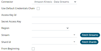

·         uncheck the Use Default Credentials Chain box and enter the Access Key ID and Secret Key Access

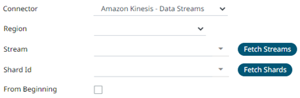

If this is the used configuration, the Use Default Credentials Chain box is not displayed in the connector UI.
This is the recommended way to provide the credentials.

·         Dedicated fields in the connector
Not the recommended configuration.

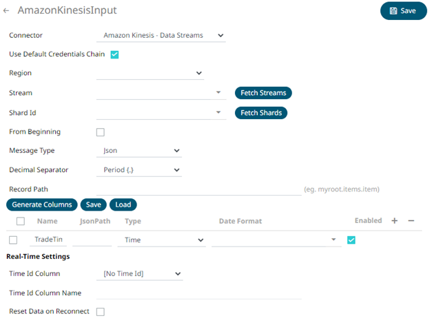

4.     Select the Message Type.
5.     Select either the dot (.) or comma (,) as the Decimal Separator.
   NOTE
Prepend 'default:' for the elements falling under default namespace.
6.      Click  to the fetch the schema based on the connection details. Consequently, the list of columns with the data type found from inspecting the first ‘n’ rows of the input data source is populated and the Save button is enabled.
7.    You can also opt to load or save a copy of the column definition.
8.    Click  to add columns to the Amazon Kinesis – Data Streams connection that represent sections of the message. Then enter or select:
