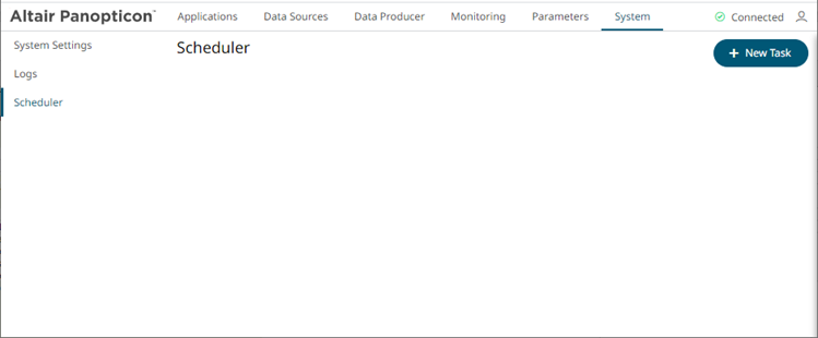

1.     Under the System page, click the Scheduler tab.
2.     Click New Task . The New Task pane displays.

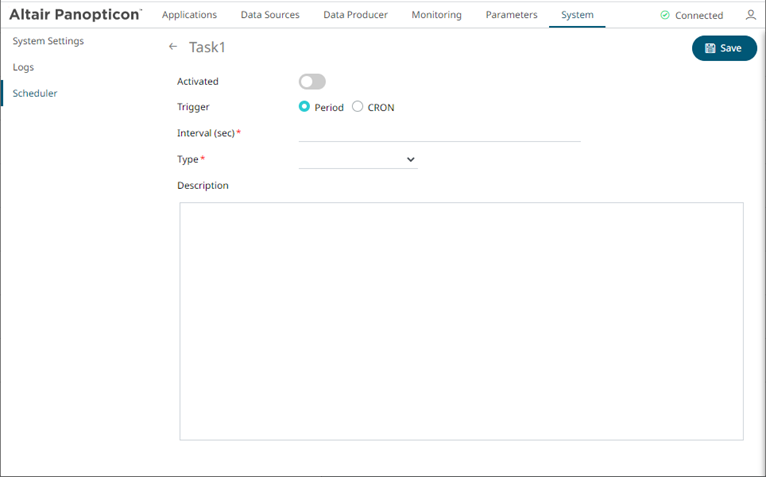

3.     Enter the Name of the task and click . Ensure the name is unique.
4.     Tap the Activated slider to turn it on.
5.     Select the Trigger. You can either select:
·         Period then enter the Interval (in seconds), or
·         CRON then enter the CRON Expression

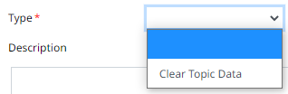

6.     Select the task Type: Clear Topic Data.
7.     Enter the Description of the task.
8.     Select the Application in the drop-down list. These are the applications available on the Applications tab.
9.     Click .

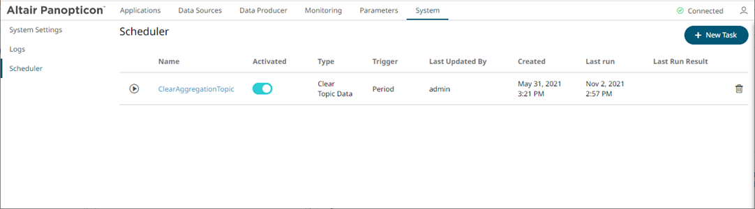

Click  to go back to the Tasks pane. The new task is added in the list.
A task displays the following columns: Name, Activated, Type, Trigger, Last Updated By, Created, Last Run, and Last Run Result.
