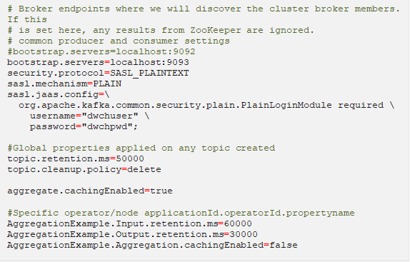

Below is a sample properties file:
# Broker endpoints where we will discover the cluster broker members. If this # is set here, any results from ZooKeeper are ignored. # common producer and consumer settings #bootstrap.servers=localhost:9092 bootstrap.servers=localhost:9093 security.protocol=SASL_PLAINTEXT sasl.mechanism=PLAIN sasl.jaas.config= org.apache.kafka.common.security.plain.PlainLoginModule required username="dwchuser" password="dwchpwd"; #Global properties applied on any topic created topic.retention.ms=50000 topic.cleanup.policy=delete aggregate.cachingEnabled=true #Specific operator/node applicationId.operatorId.propertyname AggregationExample.Input.retention.ms=60000 AggregationExample.Output.retention.ms=30000 AggregationExample.Aggregation.cachingEnabled=false

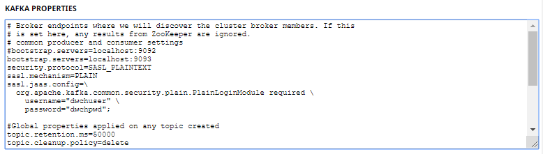

When the Panopticon Streams server is started, it checks the AppData folder for the kafka.properties  file and loads the properties in the Kafka Properties box.

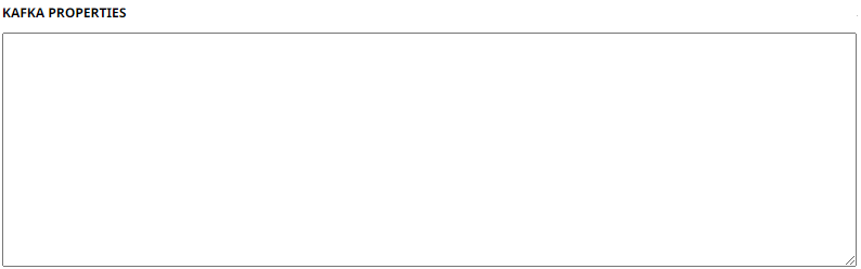

However, if the kafka.properties file is not available, the Kafka Properties box will display a blank Kafka Properties box:

·         The values in the Kafka Properties box is not editable on the System tab. Changes can be made in the actual kafka.properties  file. To reload the properties on the System tab, click Reload Configuration.
