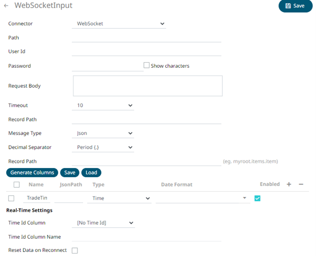

Creating WebSocket Input Data Source
The WebSocket connector is very similar to the Stream Simulator connector, except that rather than looping through a file, it would either connect through web sockets, long polling, or repeatedly poll an external URL for new records to process.
1. In the New Data Source page, select Input > WebSocket in the Connector drop-down list.
2. Enter the connection details:

3. Select the Message Type.
4. Select either the period (.) or comma (,) as the Decimal Separator.

5. Click
to
the fetch the schema based on the connection details. Consequently,
the list of columns with the data type found from inspecting the first
‘n’ rows of the input data source is populated and the Save button
is enabled.
6. You can also opt to load or save a copy of the column definition.
7. You can opt to click
to add columns to the WebSocket
connection that represent sections of the message. Then enter or select:

8. Define the Real-time Settings.
9. Click
. The
new data source is added in the Data Sources list.
