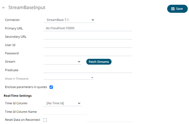

1. In the New Data Source page, select Input > StreamBase 7.1 in the Connector drop-down list.
2. Enter the following properties:
Property |
Description |
Primary URL |
Primary URL of the StreamBase 7.1. Default is sb://localhost:100000. |
Secondary URL |
Secondary URL of the StreamBase 7.1. NOTE: More than two StreamBase server URLs can be specified by comma separation. |
User Id |
User Id that will be used to connect to StreamBase 7.1. |
Password |
Password that will be used to connect to StreamBase 7.1. |

4. Enter the Predicate expression to force emission.
5. The time zone of input parameters and output data is by default unchanged. Changing the time zone is supported through the Show in Timezone list box, based on the assumption that data is stored in UTC time and outputs are presented in the selected time zone.
6. Select whether the parameters should be automatically enclosed in quotes, by checking the Enclose parameters in quotes box.
7. Check the Reset Data on Reconnect box to flush out the stale data and reload data after reconnection.
