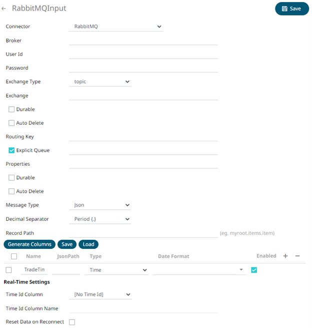

1. In the New Data Source page, select Input > RabbitMQ in the Connector drop-down list.
2. Enter the connection details including:

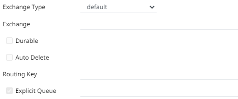

3. Select any of the following Exchange Types:
Exchange Type |
Description |
Default |
A direct exchange with no name that is pre-declared by the broker. Selecting this exchange type disables the Exchange section (Exchange and Routing Key properties).

4. Depending on the selected Exchange Type, select or define the following:

5. Check the Explicit Queue box and enter the custom queue name. Then enter or enable the following properties:

6. Select the Message Type.
7. Select either the period (.) or comma (,) as the Decimal Separator.

9. You can also opt to load or save a copy of the column definition.
10. You can opt to click
to add columns to the RabbitMQ
connection that represent sections of the message. Then enter or select:

11. Define the Real-time Settings.
13. Click
. The
new data source is added in the Data Sources list.
