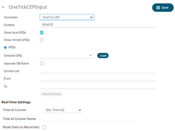

1.     In the New Data Source page, select Input > OneTick CEP in the Connector drop-down list.
2.     Enter the Context (for example, REMOTE).
3.     You can either check:
·        Show Local OTQs box to display the local OTQs in the Selected OTQs drop-down list.
·         Show Remote OTQs box to display the remote OTQs in the Selected OTQs drop-down list.
4.     Click Load   to populate the Selected OTQ drop-down list. Select an OTQ.
The OTQ Parameters section displays with the list of input parameters based on the selected OTQ.
5.     Check/uncheck the Separate DB Name box.
6.    Click  to populate the Id Column list box.
7.    From this list box select the field which will define a unique data record to subscribe against.
If an OTQ is selected, the list of input parameters that the OTQ expects is exposed, as well as the input parameters specific to the selected OTQ, the following are generic to all OTQs
·         Symbol List
·         From
·         To
These add additional filter criteria such as symbol, and time window onto the basic OTQ.
8.     Define the Real-time Settings.
9.  Click . The new data source is added in the Data Sources list.
