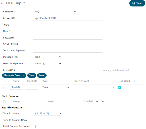

1. In the New Data Source page, select Input > MQTT in the Connector drop-down list.
2. Enter the following properties:
Property |
Description |
Broker URL |
The location of the message broker. Default is tcp://localhost:1883. |
Topic |
The topic or the queue physical name. Example: level1/level2/level3/level4 etc. NOTES: You can also opt to use a wild card in the topic name specification. · The plus sign symbol (+) can be used as a wild card for any value at one specific level. Example: level1/level2/+/level4 · The hash sign symbol (#) can be used as a wild card for any values across more than one level. Example: level1/#/level4 |
User Id |
The user Id that will be used to connect to MQTT. |
Password |
The password that will be used to connect to MQTT. |
3. To allow encrypted connections, enter the CA Certificate path of the file.
4. In MQTT, a topic consists of one or more topic levels. Enter the Topic Level Separator to use. Default is / (forward slash).
5. Select the Message Type.
6. Select either the period (.) or comma (,) as the Decimal Separator.

7. Click
to the fetch the schema
based on the connection details. Consequently, the list of columns
with the data type found from inspecting the first ‘n’ rows of the
input data source is populated and the Save button is enabled.
8. You can also opt to load or save a copy of the column definition.
9. You
can opt to click
to
add columns to the MQTT connection that represent sections of the
message. Then enter or select:

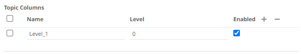

10. Text for topic levels can be consumed as additional columns into the data table.
The Topic Columns section shows and allows defining data table columns and mapping them to topic hierarchy levels (index based from left, 0 based).
Like columns from message
data, manually add them by clicking
. A new entry displays.
Name can be any unique topic level within the topic name. The Level is the hierarchy level of the topic column.
Check the Enabled box to enable a topic column.
To delete a topic column,
check its
or
all the topic column entries, check the topmost
, then click
