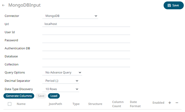

1.     In the New Data Source page, select Input > MongoDB in the Connector drop-down list.
2.     Enter the following properties:
Property
URL
Enter either:
·         localhost if the database resides on the same computer, or
·         enter the IP address and port of the computer where MongoDB is installed (e.g., 192.168.1.1:27017). If no port is specified, the default is 27017.
User Id
The user Id that will be used to connect to MongoDB.
Password
The password that will be used to connect to MongoDB.
Authentication DB
The database where the user is created.
Database
The database that will be used.
Collection
The collection that will be used.

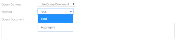

3.     You can also opt to make the Query Document feature of MongoDB to be available in the Panopticon Streams. Select Use Query Document in the Query Options drop-down list.
This also displays the Method drop-down. Select either Find (Default) or Aggregate.
When Aggregate is selected, you can add all the columns generated by aggregation in the schema.
In addition, the MongoDB command line interface displays query operations with a JSON style syntax.

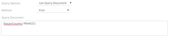

Enter your desired JSON query document. Refer to http://docs.mongodb.org/manual/tutorial/query-documents/ for more information on the Query Documents feature on MongoDB.
For example:
Queries from the documentation look like this: db.inventory.find ( {type: “snacks”} ). The database and collection are already defined in the UI and the Find operation is handled in the code. The user only needs to enter the query document:
{ type : “snacks” }
This query must include surrounding curly braces as well as matching internal braces should the user decide to make a more advanced query.
4.     Instead of using Use Query Document, select the Parameterize query option.
Click Fetch Parameters to populate the Parameter drop-down and select a value. Then select what column to filter on in the Filter By drop-down.
5.     Select either the period (.) or comma (,) as the Decimal Separator.
   NOTE
Prepend 'default:' for the elements falling under default namespace.
6.    Select the Data Type Discovery. This property specifies how many rows to fetch from the input data source, when auto generating the schema after clicking  .
7.     You can also opt to load or save a copy of the column definition.
8.     You can also opt to click . A new row displays in the JSON list box. Enter the necessary information for each column.
