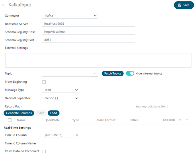

1. In the New Data Source page, select Input > Kafka in the Connector drop-down list.
2. Enter the connection details:
Property |
Description |
Bootstrap Server |
List of host/port pairs of Kafka servers used to bootstrap connections to a Kafka cluster. By default, the value is localhost:9092,broker:29092. However, this can be overridden by specifying another bootstrap server in the External Settings text box (as specified in step 3). |
Schema Registry Host |
Where the Schema Registry is located. This can be in a different location from the Kafka cluster. |
Schema Registry Port |
The port number of the schema registry which provides the serving layer for the metadata. Default is 8081. |

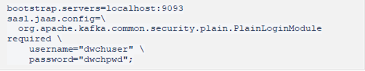

3. Enter the External Settings to support authentication (i.e., username and password). Note that if the bootstrap server is not secure, then there is no need to authenticate and you may leave this text box blank.
Below is an example of system settings for an SASL authentication:

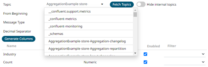

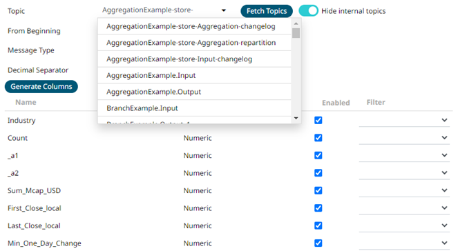

4. Click Fetch Topics to populate the Topic drop-down list.
By default, the Hide Internal Topics toggle button is enabled and the Avro message type is selected.
Tap the slider to turn it off. The internal Kafka topics are also displayed in the drop-down list.
Click the drop-down list to search and select the desired topic.

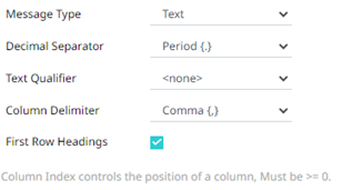

For non-Avro topics, select the Message Type: Fix, JSON, Text, XML, or Protobuf.
· If Text is selected, confirm the Text Qualifier, Column Delimiter, and if the first row of the message includes column headings.
Property |
Description |
Text Qualifier |
Specifies if fields are enclosed by text qualifiers, and if present to ignore any column delimiters within these text qualifiers. |
Column Delimiter |
Specifies the column delimiter to be used when parsing the text file. |
First Row Headings |
Determines if the first row should specify the retrieved column headings, and not be used in data discovery. |
· If JSON is selected, enter the Record Path which allows the identification of multiple records within the JSON document (e.g., myroot.items.item).
Property |
Description |
Record Path |
The record path that will be queried by the connector’s path (e.g., myroot.items.item). |

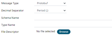

· If Protobuf is selected, confirm the Decimal Separator, and enter the Schema Name and Type Name.
Then click
to select the File Descriptor
(.desc
file) in the Open dialog.
Property |
Description |
Schema Name |
The Protobuf schema. |
Type Name |
The message of Protobuf type that will be sent to Kafka. |
File Descriptor |
The FileDescriptorSet which: · is an output of the protocol compiler. · represents a set of .proto files, using the --descriptor_set_out option. |
