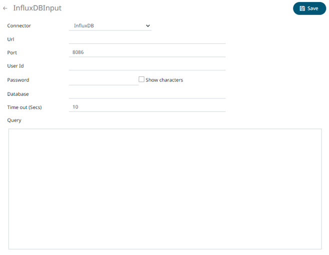

1. In the New Data Source page, select Input > Influx DB in the Connector drop-down list.
2. Enter the following information:
Property |
Description |
URL |
InfluxDB host address. |
Port |
InfluxDB host port. Default is 8086. |
User Id |
The user Id that will be used to connect to the InfluxDB service. |
Password |
The password to connect to the InfluxDB service. Check the Show Characters box to display the entered characters. |
Database |
The name of the database that will communicate over the HTTP(S). |
Time out (Secs) |
The time out period applied to both the TCP socket and for individual read IO operations. Default is 10. |
3. Enter an SQL-like query language into the Query box.
4. Click
. The
new data source is added in the Data Sources list.
