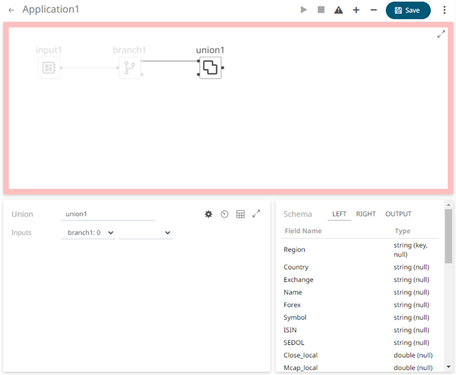

1.    In the Application page, click  and select Union in the Context menu that displays.
The Union node  icon displays in the Graph panel, as well as the properties to be defined in the Operator Settings panel, and the preview of the data in the Schema panel.
The left (inbound) edges allow you to select the input streams. The right (outbound) edge allows you to connect to the other operators.

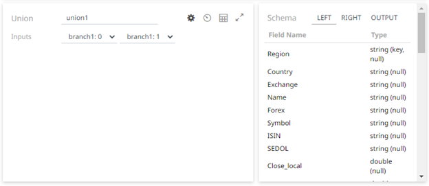

2.    In the Operator Settings panel, define or select the following required properties:
Property
Union
The ID the union operator.
Inputs
The left input stream automatically connects to the currently-selected operator. You can select another ID of the operator that will be the source of the data in the Inputs drop-down list.
Then select the right input stream.
The preview of the data (LEFT, RIGHT and OUTPUT) is displayed in the Schema panel.
