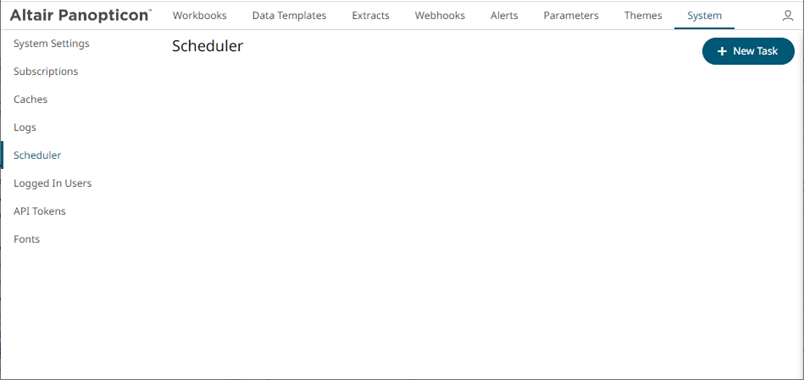

On the Scheduler tab of the System Settings page, Panopticon Visualization Server allows scheduling of tasks.
A new scheduled task is added in the list with the properties.

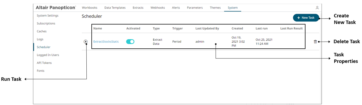

Scheduler Property
Run Task
Manually run scheduled task.
Create New Task
Create a new scheduled task.
Delete Task
Delete a scheduled task.
Task Properties
The task properties include:
·         Name of the task
·         Activated status
·         Type of the scheduled task
·         Trigger type: Period or CRON
·         Last user who made an update
·         Date/Time when the task was created
·         Date/Time when the task was last ran
·         Last run result: Success or Failed
For failed results, you can hover on the tooltip to view the error.
NOTE: The result is not displayed for Extract Data scheduler type.

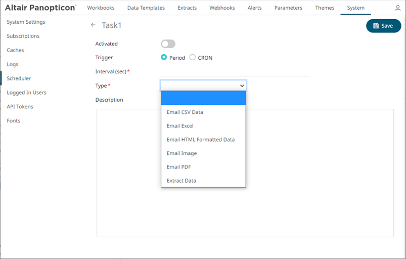

To create a new task, click . The New Task pane displays that allows you to define the following tasks:
q  Sending of a CSV Data via Email
q  Sending of an MS Excel file via Email
q  Sending of an HTML Formatted Data via Email
q  Sending of an Image file via Email
q  Sending of a PDF file via Email
q  Extracting Data
   NOTE
·         To allow scheduling of email send outs, the Panopticon Visualization Server must be configured with valid email server information in the Panopticon.properties file located in the AppData folder (e.g., c:\vizserverdata).
See Panopticon Visualization Server Configurations for Email Send Outs and Alerts for instructions.
·         If any data load fails, such as when the data source is offline, the PDF/Image generation fails as well and an email will not be sent.
