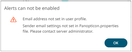

If alerts are required to be sent via email, the Panopticon Visualization Server must be configured with valid email server information in the Panopticon.properties file located in the AppData folder (e.g., c:\vizserverdata).
See Panopticon Visualization Server Configurations for Email Send Outs and Alerts for instructions.
Otherwise, when trying to enable an alert, this error will be displayed:
In addition, you can also set the alert.creation.only.by.administrators property to true to only enable Administrators to create alerts.
