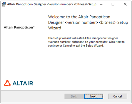

The Setup Wizard displays:
2. Click Next.

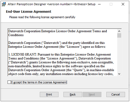

The End-User License Agreement dialog displays:
3. Read and check the I accept the terms in the License Agreement box then click Next.

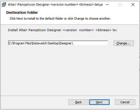

The Destination Folder dialog displays:
4. Confirm the installation folder.
5. Click Next.

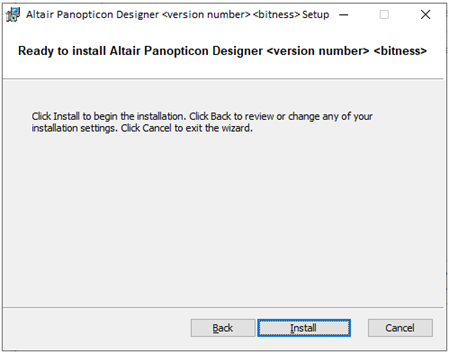

The Confirm Installation dialog displays:

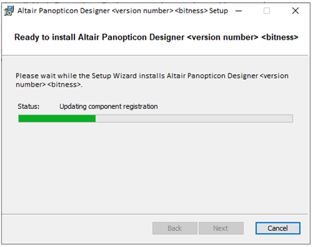

6. Click Install to confirm the installation. You will be informed about the progress of the installation process:
Installation typically takes less than 30 seconds.

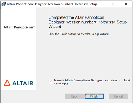

You will be notified once the installation is complete:
7. And finaly, click Finish.
