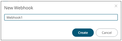

1.      On the Webhooks tab, click on a folder then .
The New Webhook dialog displays.
2.     Enter the name of the webhook then click .
The new webhook is displayed on the Webhook page.

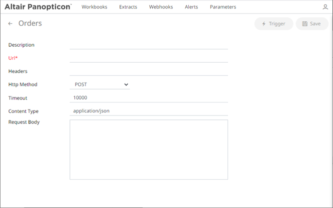

3.     Enter or select the following webhook properties:
Property
Description of the webhook.
URL
URL of the webhook. This property is required.
Headers
A comma separated list of name=value pairs representing HTTP headers.
HTTP Method
Select the appropriate HTTP method for the request from the following options:
·         GET – retrieve data
·         POST – add new data
·         PUT – replace existing data
·         DELETE – remove existing data
Timeout
Timeout (in ms) for reading a response from the URL.
Content Type
The content type of the request body. Default is application/json.
Request Body
The request body to be supplied to the HTTP call.
For example:
    'Alert title': '{_alert_title}',
    'Alert dashboard URL': '{_alert_dashboard_url}',
    'Alert description': '{_alert_description}',
    'Alert reason': '{_alert_reason}',
    'Triggering items': '{_alert_triggering_items}',
    'Timestamp': '{_current_time}',
    'Folder': '{_workbook_folder}',
    'Workbook': '{_workbook_name}',
    'Dashboard': '{_dashboard_name}'
4.     Click  to save the new webhook.
5.     You may opt to click  to trigger the webhook. Any parameter in the request body will be replaced by its value when triggering the webhook request.

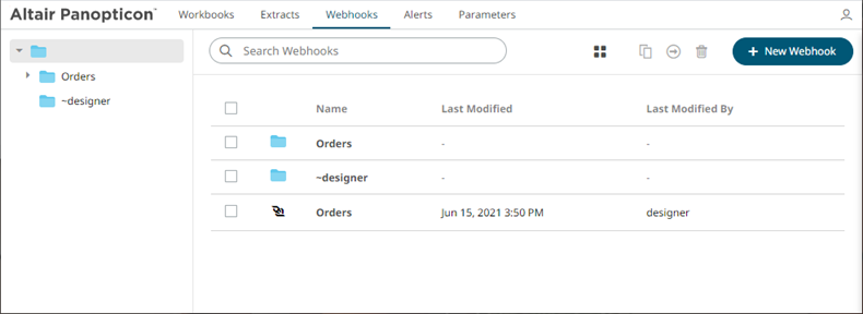

6.     Click  to go back to the Folders and Webhooks list. The new webhook is added on the list.
