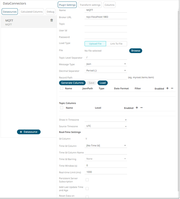

1. Select MQTT from the Data Sources pane. The MQTT Settings pane and the retrieved MQTT source are displayed.
2. Enter the Name of the MQTT data source, then click
3. Enter the following properties:
Property |
Description |
Broker URL |
The location of the message broker. Default is tcp://localhost:1883 |
Topic |
The topic or the queue physical name. |
User Id |
The user Id that will be used to connect to MQTT. |
Password |
The password that will be used to connect to MQTT. |

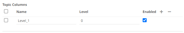

11. Text for topic levels can be consumed as additional columns into the data table.
The Topic Columns section shows and allows defining data table columns and mapping them to topic hierarchy levels (index based from left, 0 based).
Like columns from message
data, manually add them by clicking
. A new entry
displays.
Name can be any unique topic level within the topic name. The Level is the hierarchy level of the topic column.
Check the Enabled box to enable a topic column.
To delete a topic column,
check its
or
all the topic column entries, check the topmost
, then click

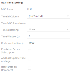

13. For this section:
Refer to Define Real-Time Settings for more information.
