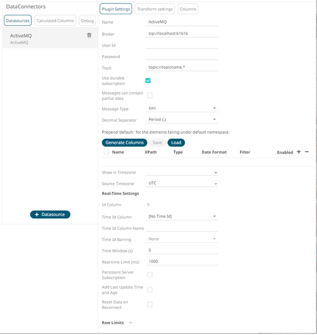

1. Select ActiveMQ from the Data Sources pane. The ActiveMQ Settings pane and the retrieved ActiveMQ source are displayed.
2. Enter the Name of the ActiveMQ
data source, then click
3. Enter the following information:
Property |
Description |
Broker |
The location of the message broker. Default is tcp://localhost:61616. |
User Id |
The user Id that will be used to connect to the ActiveMQ service. |
Password |
The password to connect to the ActiveMQ service. |
Topic |
Accepts topic in topic://topicname.* format and also topicname.*. Therefore, topic://pano.> and pano.> both will work as topic value. Default is topic://topicname.* |
4. Check/uncheck the Use durable subscription box.
