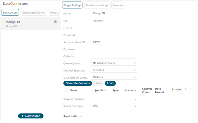

1. Select MongoDB from the Data Sources pane. The MongoDB Settings pane and the retrieved MongoDB source are displayed.
2. Enter the Name of the MongoDB
data source, then click
3. Enter the following properties:
Property |
Description |
URL |
Enter either: · localhost if the database resides on the same computer, or · enter the IP address and port of the computer where MongoDB is installed (e.g., 192.168.1.1:27017). If no port is specified, the default is 27017. |
User Id |
The user Id if authorization is enabled for MongoDB. |
Password |
The password if authorization is enabled for MongoDB. |
Authentication DB |
The database where the user is created (default is admin). |
Database |
The database that will be used. |
Collection |
The collection that will be used. |

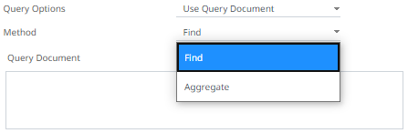

You can also opt to make the Query Document feature of MongoDB to be available in Panopticon.
Select Use Query Document in the Query Options drop-down list.
This also displays the Method drop-down. Select either Find (Default) or Aggregate.
When Aggregate is selected, you can add all the columns generated by aggregation in the schema.

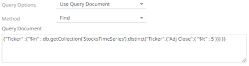

In addition, the MongoDB command line interface displays query operations with a JSON style syntax.
Enter your desired JSON query document. Refer to http://docs.mongodb.org/manual/tutorial/query-documents/ for more information on the Query Documents feature on MongoDB.
For example:
Queries from the documentation look like this: db.inventory.find ( {type: "snacks"} ). The database and collection are already defined in the UI and the Find operation is handled in the code. The user only needs to enter the query document:
{ type : "snacks" }
For more advanced query, it must include surrounding curly braces as well as matching internal braces.

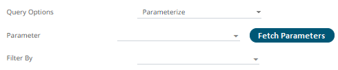

5. Instead of using Use Query Document, select the Parameterize query option.
Click Fetch Parameters to populate the Parameter drop-down and select a value. Then select what column to filter on in the Filter By drop-down.
