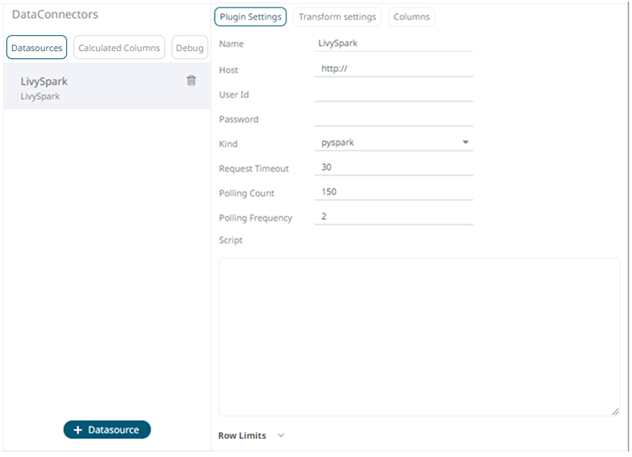

1. Select LivySpark from the Data Sources pane. The LivySpark Settings pane and the retrieved LivySpark source are displayed.
2. Enter the Name of the Livy Spark
data source, then click
3. Enter or select the following properties:
Property |
Description |
Host |
Livy Spark host address. |
User Id |
User Id that will be used to connect to Livy Spark. |
Password |
Password that will be used to connect to Livy Spark. |
Kind |
Currently, the supported kind of connection to be used is pyspark (Interactive Python Spark session). |
Request Timeout |
Length of time to wait for the server response. Default is 30. |
Polling Count |
The number of polling done to the Livy Spark server to check if the status of the app is successful. Default limit is 150. |
Polling Frequency (in seconds) |
Frequency of the polling. Default is 2. |
Script |
The script to use. |
4. Set the row limit of the data set.
5. Tap the Preview Selected Data Source slider to turn it on.
6. Click
to
display the data preview.
