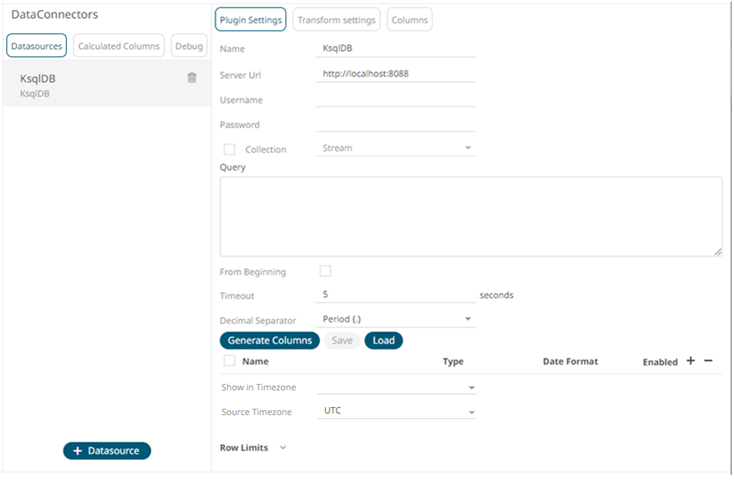

1. Select ksqlDB from the Data Sources pane. The ksqlDB Settings pane and the retrieved ksqlDB source are displayed.
2. Enter the Name of the ksqlDB
data source, then click
3. Enter the following properties:
Property |
Description |
Server URL |
ksqlDB host address. |
Username |
User Id that will be used to connect to ksqlDB. |
Password |
Password that will be used to connect to ksqlDB. |
