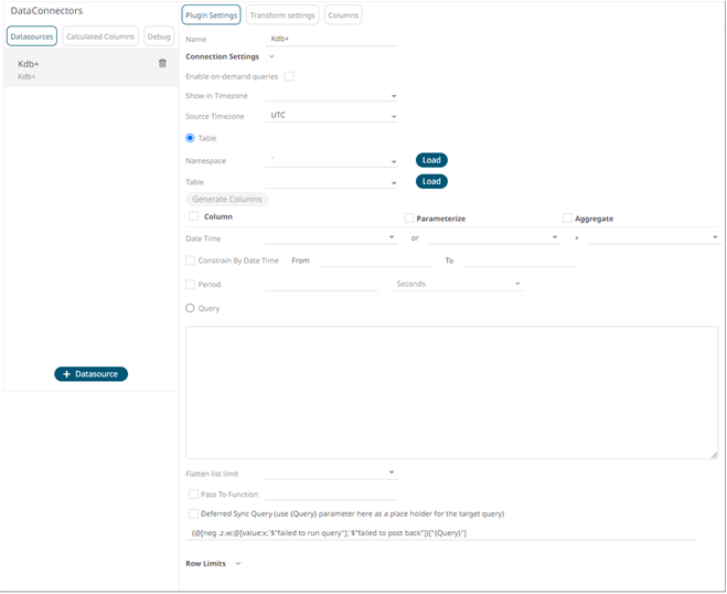

1.     Select Kdb+ from the Data Sources pane. The Kdb+ Settings pane and the retrieved Kdb+ source are displayed.
2.     Enter the Name of the Kx kdb+ data source, then click .

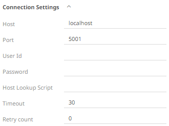

3.     Click Connection Settings to expand and display the properties you can set.
4.     Enter the following properties:
Property
Host
Kx kdb+ host address.
Port
Kx kdb+ host port. Default is 5001.
User Id
The user Id that will be used to connect to Kx kdb+.
Password
The password that will be used to connect to Kx kdb+.
Host Lookup Script
Key of the authentication script setting that will be retrieved from the Panopticon.properties file which is available in the AppData folder of the Panopticon Visualization Server.
The authentication script setting will issue a shell script call passing a JSON structure containing host, port, username, and password (as below).
{ "host": "host",
"port": 5001,
"username": "username",
"password": "password"}
NOTES:
·         The port should be a number and has no double quotes. This is done to avoid unwanted casts.
·         Only host and port are mandatory.
Calling the script in-process from the Tomcat server running Panopticon allows automatic pick-up of the Kerberos token of the system account that started the Tomcat process.
NOTE:
An exception will be thrown if the key used in the connector is not configured in the Panopticon.properties file.
Timeout
The length of time to wait for the server response. Default is 30.
Retry Count
Number of connection attempts to be done that can be used for busy Kx kdb+ servers. Default is 0.
   NOTE
Host, Port, User Id, Password, and Host Lookup Script can be parameterized.

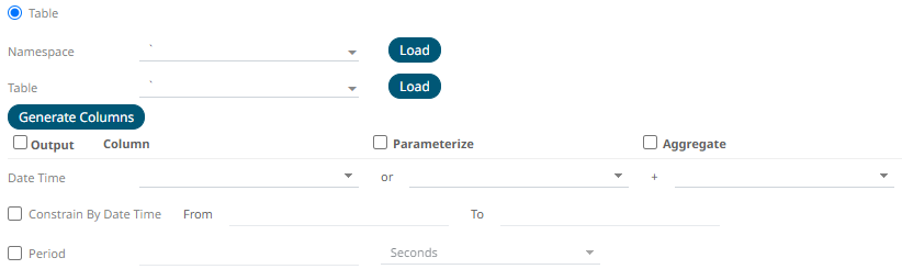

8.     When Table is selected, the section below is enabled:
The Namespace drop-down is an editable combo box.
You can either:
·         click  and select a namespace from the list of all root level namespaces. By default, the selected namespace will be root (backtick `).
·         For nested namespaces, enter them in the Namespace box (e.g., panopticon.test) to get the tables that were created under these namespaces.
9.     On the Table field, click  to populate the drop-down list with tables and views. Select a table or view.
10.     Click . The columns of the selected table or view populates the Output Column section.

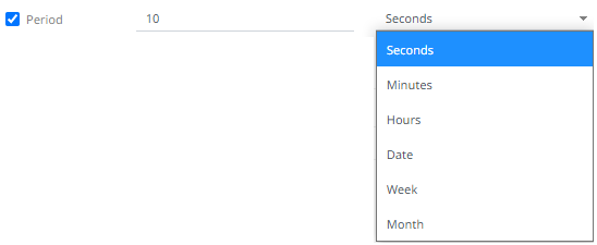

15.   In kdb+, you can modify the query to regroup the aggregated data per time units (i.e., Seconds, Minutes, Hours, Date, Week, Month). Check the Period box, enter the time duration and click  then select the time unit.
