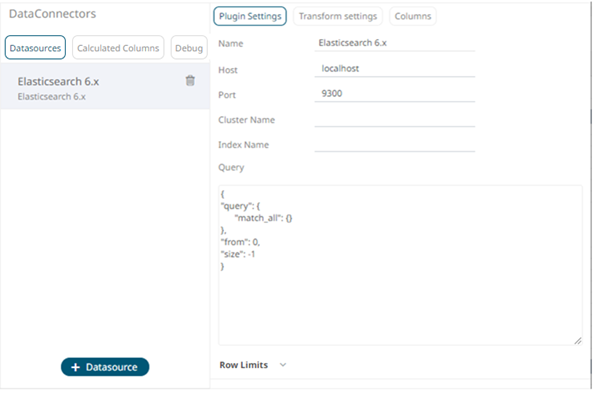

1. Select Elasticsearch 6.x from the Data Sources pane. The Elasticsearch 6.x Settings pane and the retrieved Elasticsearch 6.x source are displayed.
2. Enter the Name of the Elasticsearch
6.x data source, then click
3. Enter the following information:
Property |
Description |
Host |
The hostname of any node in your Elasticsearch cluster, or localhost for a node on your local machine. |
Port |
The port running the Elasticsearch HTTP service (default is 9300). If the port you wish to use is different from the default port, change the value to the correct one. |
Cluster Name |
The cluster name that can be used to discover and auto-join nodes. |
Index Name |
The Index name in Elasticsearch. This is some type of data organization mechanism that allows partition of data in a certain way. |
4. Enter an optional JSON-encoded request body in the Query box.
5. Set the row limit of the data set.
6. Tap the Preview Selected Data Source slider to turn it on.
7. Click
to
display the data preview.
