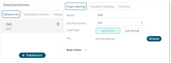

1.     Select SVG from the Data Sources pane. The SVG Settings pane and the retrieved SVG source are displayed.
2.     Enter the Name of the SVG data source, then click .
3.     Select the SVG File Source.
Ensure that in a cluster, you need to use a a shared path, or put it on every node and use a path that resolves on every node. You can update its contents whenever you want.
