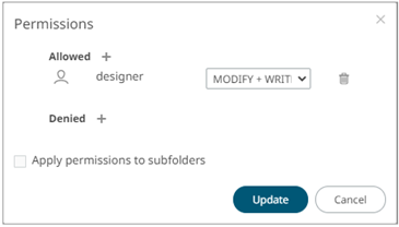

1. Right-click on a folder and select Permissions on the context menu.
The Permissions dialog displays.

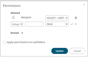

2. Under the Allowed section, click
the Add
icon.
A new User/Group Allowed section is displayed.
3. Select User or Group to be given permission in the drop-down list.
4. Enter the user or group Name.
5. Select the permission level that will be grated to the user or group:
· READ
Permission to read the folder.
· READ + WRITE
Permission to write to the folder and read.
· MODIFY + WRITE + READ
Permission to read, modify, and write to the folder as well as create subfolders.
6. Click
. The user or group is added under the
Allowed list.

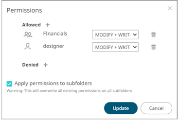

7. You can either:
· check the Apply Permissions to Subfolders box
This means the permissions that will be used on all of the subfolders will be fetched from the parent folder.
NOTE |
The Apply Permissions to Subfolders check box is only enabled when there is an existing subfolder.
· leave the Apply Permissions to Subfolders box unchecked and modify the permission properties of the subfolders
8. Click
to save the changes.
