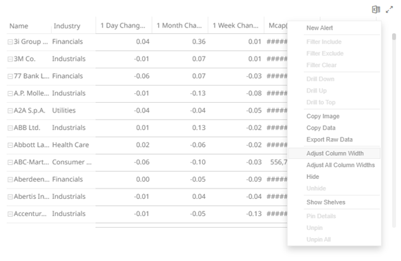

Right-click on a column name and then select either:

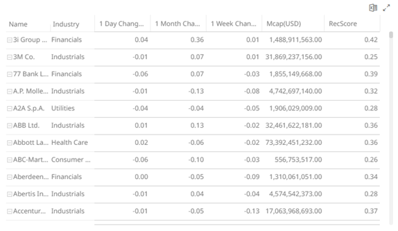

q  Adjust Column Width
The column width is adjusted.

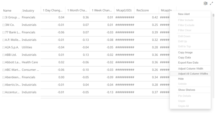

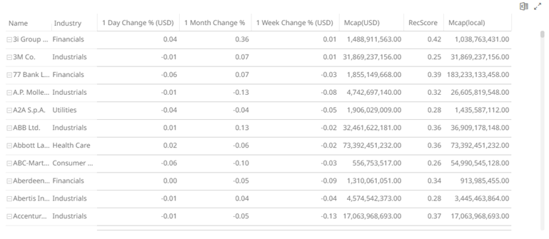

q  Adjust All Column Widths
All of the column widths of the table are adjusted.

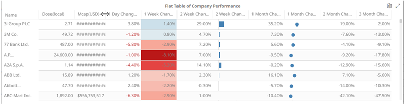

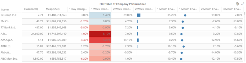

Aside from selecting either of these context menu options, you can also manually drag the Left-Right arrow  to widen or reduce the width of the columns.
Hover on a column border, the Left-Right arrow displays.
Drag the arrow to the desired width.
