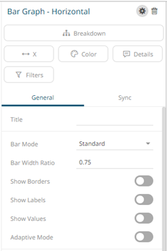

The bar graph
settings pane is displayed after clicking the Settings
icon or
the Visualization Title (i.e., Bar Graph – Vertical):
Setting |
Description |
Bar Mode |
Specifies the mode of the bar graph, which can be Standard, Stacked, or Grouped.
Bar Width Ratio (%) |
Defines the ratio of the width within the bars. Default is .75. |
Show Borders |
Determines whether borders are drawn around bars or stacks within bars. |
Show Labels |
Determines whether labels are drawn inside the bars or not. |
Show Values |
Determines whether values are displayed on each bar or not. |
Adaptive Mode |
Automatically swaps to the Standard mode when displaying the top items within a hierarchy. |
Value Margin |
The width of the margin of the Values from the border. |

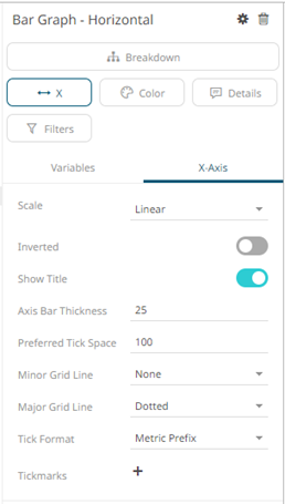

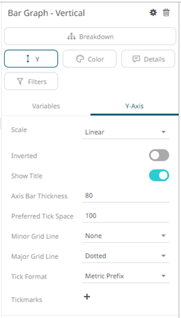

Other visualization-specific properties can be set by clicking on either:
q Y-Axis variable drop area then selecting the Y-Axis tab (for Vertical Bar Graphs) or
q X-Axis variable drop area then selecting the X-Axis tab (for Horizontal Bar Graphs)
