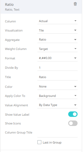

Setting the Column to Actual and the Weight Column to Target with the format set to 0.0% results to the following Ratio values:
