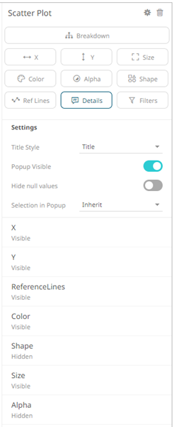

1.     Click on the Details button of a visualization. The Details Settings pane displays along with the available variables of the visualization.
Sample 1: Scatter Plot visualization has HeightX, HeightY, Size, Color, Alpha, Shape, and Reference Lines variables.

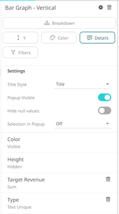

Sample 2: Bar Graph – Vertical visualization has HeightY and Color variables.
2.     Select the Title Style: Title, Visible Path, or Full Path.
3.     By default, Popup Visible is enabled to display the Details pop-up. Tap the slider to turn it off.
4.     Tap the Hide Null Values slider to turn it on.

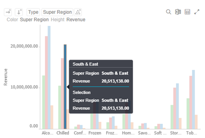

5.     Select the Selection in Popup:
·         On
The Details pop-up of the selection in the visualization is displayed.
·         Off
The selection in the Details pop-up is turned off.
·         Inherit
The selection option in the Details pop-up is inherited from the workbook properties.
6.     You can also drag and drop numeric columns from the Data Table pane to the Details  button on the Visualization Settings pane.
The column is added under the Details pane.
7.     Click on the column to display the configuration pane.

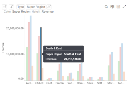

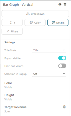

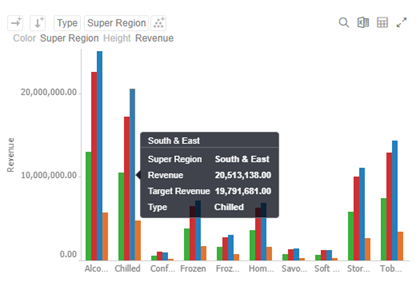

19.   By default, all of the variables are set to be Visible on the Details pop-up.
For example, when the Height variable column is Revenue and set to Visible, the value of Revenue is displayed in the Details pop-up.
Tap the Visible slider to turn it off so the variable detail will not be displayed.
