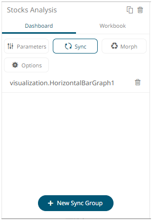

The synchronized variables of a visualization can be shared with other visualizations using the same data table.

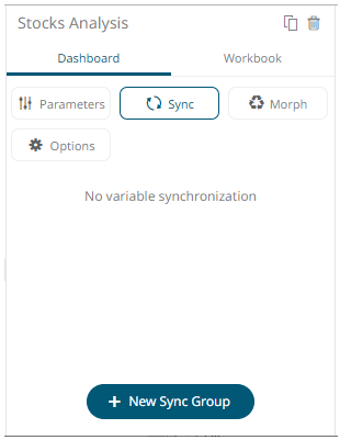

1. On the Dashboard and Workbook Settings pane, click the Dashboard tab and then the Synch button.
2. Click
. The Main visualization is displayed.
By default, this is the first defined visualization of the dashboard.
For example:

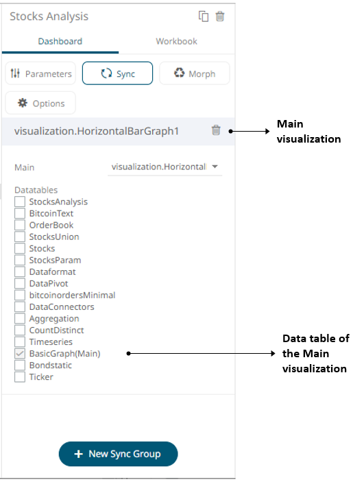

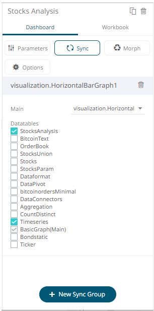

3. Click on this visualization. All of the available data tables in the workbook are displayed and the corresponding data table of the main visualization is also indicated.
4. You can opt to check one or more data tables.

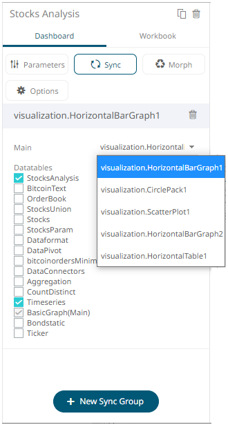

5. Click on the Main drop-down list and select the main visualization.
NOTE |
The synchronized variables of this visualization will be the basis for the child or dependent visualizations using the selected data tables.

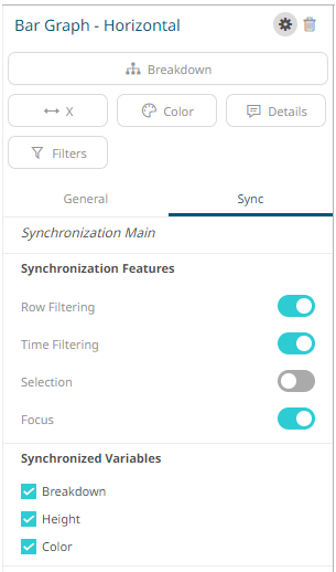

6. To define the shared variables of a
main visualization, click its Settings
icon. The corresponding Properties
pane displays. Click the Sync tab.

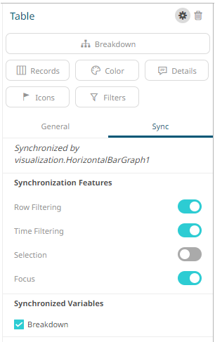

It is indicated at the top section of the tab that this visualization will be the Synchronization Main and will be the basis for the shared and visible variables across the selected data table(s).
Check the Synchronized Variables boxes of the variables that will be shared by the main visualization to its dependents.
For the child visualizations, the main visualization to which it will be synchronized into is indicated as well. For example “Synchronized by visualization.HorizontalBarGraph1”.
