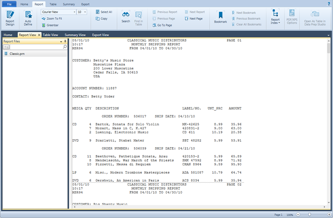

Monarch Classic displays the report in Report View.
A report displayed in the Report window.
