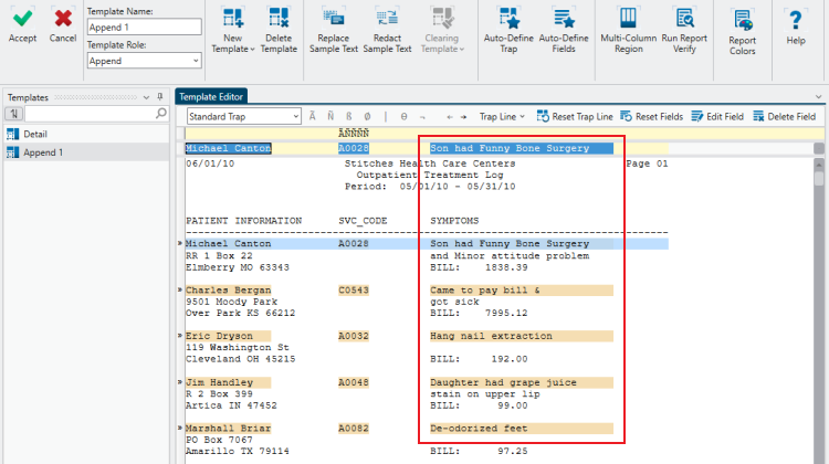

Some reports contain description fields that wrap onto multiple lines. Some multiple line fields always occupy a fixed number of lines, but others occupy a variable number of lines. An example of each appears in the illustrations below.
The SYMPTOMS field always contains a fixed number of lines.
The DESCRIPTION OF SERVICE field contains a varying number of lines.
You can use Monarch Classic to extract these fields by indicating the field's starting and ending locations.

  1. Open a report containing data you want to capture spanning multiple lines and then go to Report Design.
  2. Select a line or group of lines that contain a single instance of the multiple line field. Extend the selection only as far as required to highlight the first line of the multiple line field. You do not need to highlight all of the lines occupied by the field, only its first line. Later, you'll learn how to extend the field definition to include the remaining lines occupied by the field.
  3. Click New Template and then select a template role (typically Detail or Append).
  4. Create a trap to capture all instances of the template.
  5. Scroll through the report to satisfy yourself that the trap captured all instances of the selected level. At this point, the trap needs to capture only the first line of the multiple line field. Later, you'll learn how to capture the remaining lines occupied by the multiple line field.
    If the trap missed any instances of the selected level, inspect those lines to determine what modifications you need to make to the trap in order to capture them. After making the modifications repeat steps 4 and 5.
    After you are satisfied that the trap is working to capture all of the lines occupied by the selected level, but not lines from other levels, you are ready to highlight the multiple line field, along with any single lines fields that you also want to capture.
  6. Highlight the first line of the multiple line field. You may also highlight any single-line fields that you might want to extract using this template.
  7. Click on the first line of the multiple-line field so that it is selected and then click Edit Field in the Template Editor toolbar. This action displays the properties of the multiple-line field.
  8. In the General tab, type a name for the field in the Name box and then specify settings for each of the available options (Note: For a detailed explanation of these options, see Input Field Properties).
  9. Select the Advanced tab. The Advanced tab includes options for defining a multiple line field.

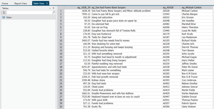

    In Table view, the extracted data should display as follows.
Note: If you want to break the multiple line text block into separate lines after extracting it, see the Textline function for more information.
