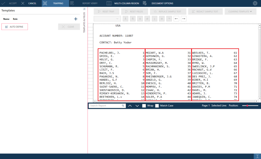

  1. Open the report from which you want to extract multiple-column data in Report Design and then select the Multi-Column Region tool. The Multi-Column Region Definition toolbar displays.
  2. Select Activate Columns from this toolbar to activate the definition window.
  3. Examine the report to determine how many columns of data there are, then enter the number in the Number of Columns field.
    A series of red, vertical broken lines, or column indicators, appears over the report to indicate where the columns currently are. The number of columns you specified determines the number of column indicators that appear (e.g., if you specified 3 in the Columns box, three column indicators appear).

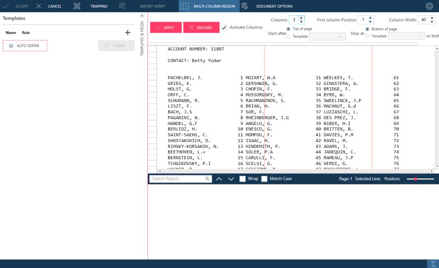

  4. Use the First Column Position box to specify a left margin for the leftmost column, i.e., the position where you want the leftmost column to begin. The column indicators are shifted to the left according to the number of spaces you entered in the box.
    Note: The default First Column Position setting is "1." If the text in the left-most column begins at the left edge of the report, leave the setting at "1". If the text begins one space in from the left edge of the report, enter "2". If the text begins two spaces in from the edge of the report, enter "3", and so on.
  5. Use the Column Width box to specify the desired column width. To do so, either enter a number in the box or use the arrows to increase or decrease the current column width.
    The column indicators move to reflect the change to the column width. Examine the current column width and, if necessary, adjust it so that each column of data is entirely contained within each column as outlined by the column indicators.

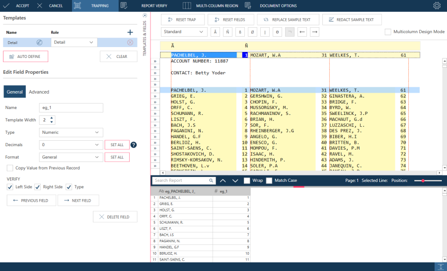

  7. Select a sample line for which you wish to create a template.
  8. In the Report Design window, click + (Add a New Template) and then select a template role from the options available.
  9. Create traps to extract the desired fields, as you would with any non-MCR template and then save the template.
  10. Select Verify from the Report Design ribbon to make sure the fields in your template have been defined properly.

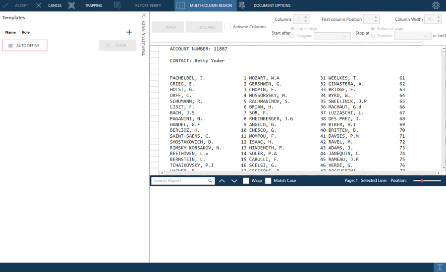

  11. Select the Multi-Column Region tab once more. The Multi-Column Region Definition panel displays.
  12. Select a Start After option from the drop-down provided to specify the top boundary of the MCR.
    Select the Top of Page option to begin the MCR at the top of the page. To begin the MCR immediately after a particular template, select this template from the drop-down list.
    Note that the top boundary line of the MCR (i.e., the red, horizontal broken line at the top of the columns) is adjusted to reflect the setting you’ve specified. This line indicates the top boundary of the multi-column region. Everything above this line is excluded from the MCR.
  13. Select a Stop After option to specify the bottom boundary of the MCR.
    Select the Bottom of Page option to end the MCR at the bottom of the page. To end the MCR immediately before a particular template, select this template from the drop-down list.
    Note that the bottom boundary line of the MCR (i.e., the red, horizontal broken line at the bottom of the columns) is adjusted to reflect the setting you’ve specified. This line indicates the bottom boundary of the multi-column region. Everything below this line is excluded from the MCR.
